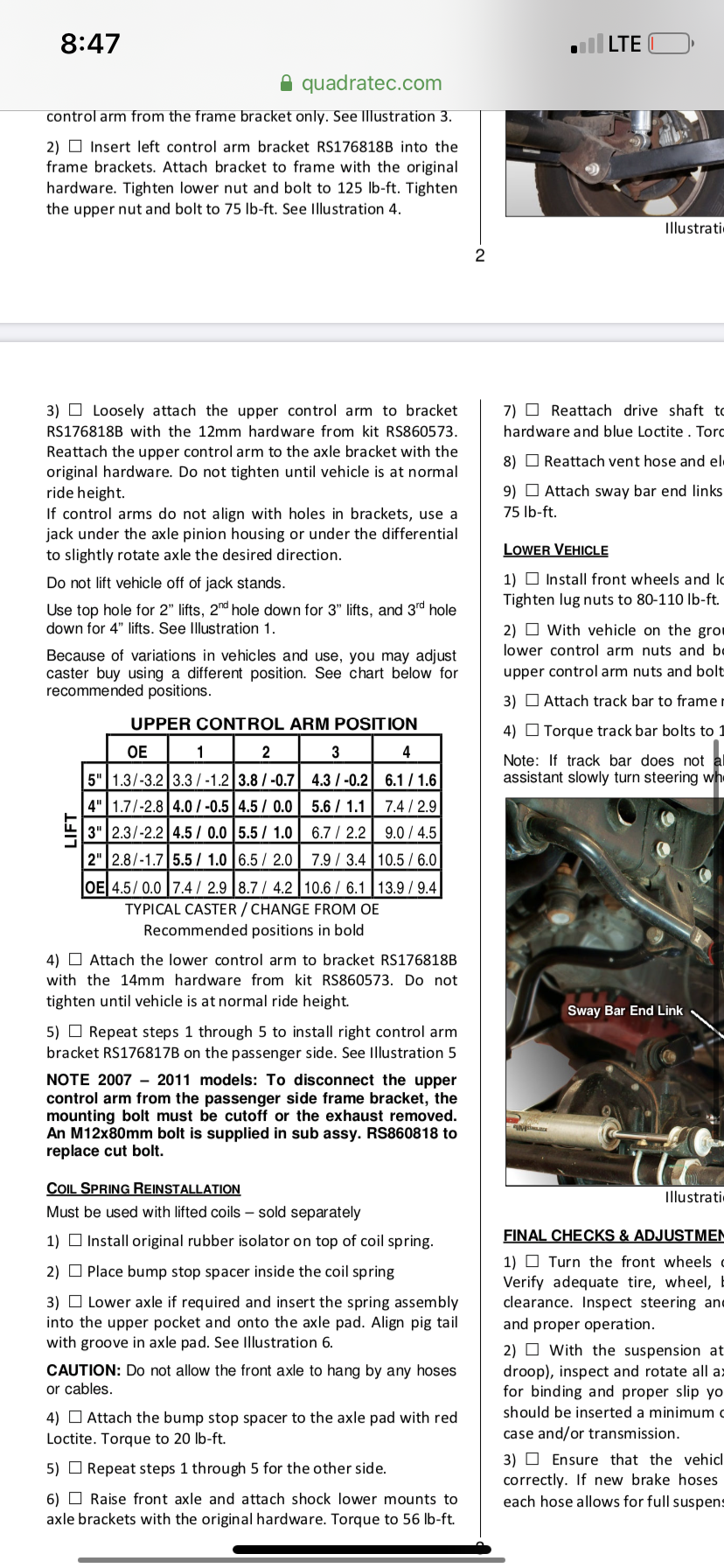

Hey guys new here. I have done a bit of searching but I don’t see if anyone has tried this setup yet. I have a 2016 Jeep JKU Sahara. I am building it to be a pavement princess so it won’t flex I just want the best on road ride. I bought the Teraflex 3” lift with the 4 Sport Arms and the front Adjustable Trackbar because I got a great deal on it for covid and I love the look of the 3” over the 2.5”. I’m starting to think I made a mistake with the Sport arms. After doing a bit of research it seems that the geometry correction brackets would be a better fit because they correct the geometry and the caster instead of just the caster with the sport arms. I am looking for the best on road ride/closest to stock with this lift. The kit comes with the front lowers and rear uppers. Would I be OK to run the sport arms only being 3/16 longer than stock with the geometry correction brackets? Maybe in the 2” setting instead of 3” to compensate for the slightly longer arm? Or would I just be better off scrapping the front lower sport arms and using the stock arms with the geometry correction brackets? I've heard from a few people that the sport arms ride harsh in the stock locations. I’m assuming because of the new angles the lift created. That is certainly the last thing I am looking for.

also depending on what geo brackets you get the holes will be different. Ie AEV does not recommend geo brackets with under 2.5" lift and actually gives you measurements from spring perch to frame to determine which holes to use. Rancho says using the the top hole ie the one for a 2" lift will give a 3" lift 4.5* caster. If you combine the longer control arms with the geo brackets even in the top hole you are going to have in excess of 6.5* caster most likely. It makes no sense that you want to improve your ride but you are willing to cause other issues like Dirtman says vibration at drive shaft which can cause damage to Transfer case etc. Also your steering will be slow with too much caster. Caster is one of those things that too little is bad but so is too much.
dang I wasn’t really thinking of it like that with the over caster thing. What does too much caster cause? I do have the longer rear upper sport arms so I was hoping those would help with adjusting that pinion angle on the lift addressing the driveshaft issues. Is that correct?
talking completely hypothetically here, I will have a very light rig with a spare delete and aluminum bumpers. I’m figuring I’ll actually gain closer to 4” from the teraflex 3” springs. If that was the case, at 4” actual lift running the sport arms and the rancho geometry brackets in the 2” setting per the rancho directions I would be at 4.5 or oe caster. If I got 3” of actual lift than I’d be at 5.5 caster which they say is still good in their directions. Does this look right?

The drive shaft angles in the rear on the 4dr are very forgiving with CV joints on both ends. Most people don't even bother with rear arms till they are at the point of needing to push the rear axle back out....primarily to accommodate larger tires. You're not really gaining anything by using both the sport arms AND the brackets. I was merely saying earlier that it was possible as long as it left you with an acceptable caster. I know you're trying to make them work cuz you got such a good deal, but making things work isn't always the best idea. I think you'd probably be better off just using factory arms with the brackets and selling the sport arms to recoup some funds. There's no damage to pride in doing so.
Also, "acceptable" caster isn't an exact target, but most of us run in the 4-5* range. Get your caster too high and you're drive shaft (and subsequently the TC) isn't going to like you. That front shaft is going to have a hard enough time at 3+ inches as it is.
