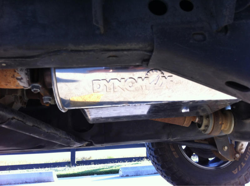

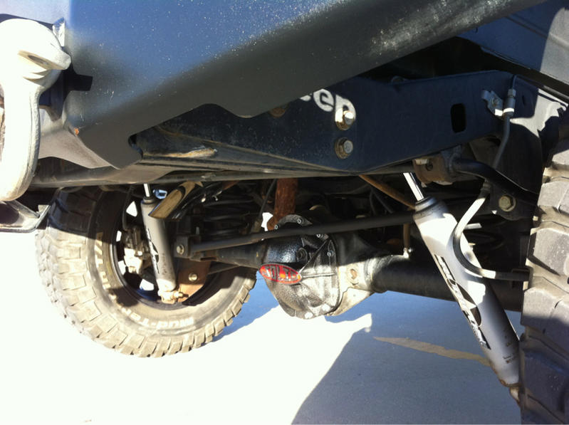

I did the same with the muffler dynomax uses for their rock krawler system. I got the muffler part # from looking at their cat back krawler system and ordered from summit. Welded it up and bought a turn down at the local parts store.
Not sure why that first pic is in there, but I also painted everything black with high temp engine paint. Said and done, cost about $75 and sounds and works just as good as the bought system.
