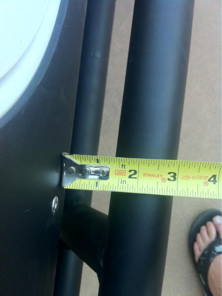

MTG's Avatar
MTG
Posts: 959
From: Reno eNVy
Get EVO and be done with it.
Edit: had to get my phone out...
There is enough of a step to work, but they don't stick out far enough to be a problem.
