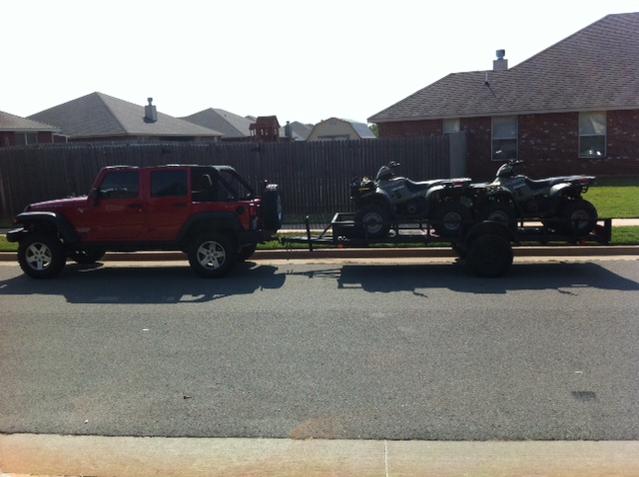

Rancho also has $500 off of their 4" sport kit/9000 series shocks until the end of August. Cost me $540 after the discount and it rides amazing!Attachment 200892
