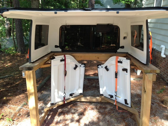

Here's my solution. While I'd like to take credit for it, I actually saw something very similar on one the many Jeep forums. I changed it slightly, adding the 45* angled supports and offsetting them enough bottom to top, to accommodate the two roof panels. The height is level with the edge of the top. The front vertical post line up with the outside edges of the square protrusions on the bumper. Slid into place, the tailgate / spare tire will not open completely, but enough I can get inside, sit and push up and start it backward. Once about half off, I get out, close tailgate, get under roof, lift and slide. Go reverse for putting back on. It likely helps that I am 6'3". Very happy with the set up. I now don't have to rely on a neighbor to assist.
