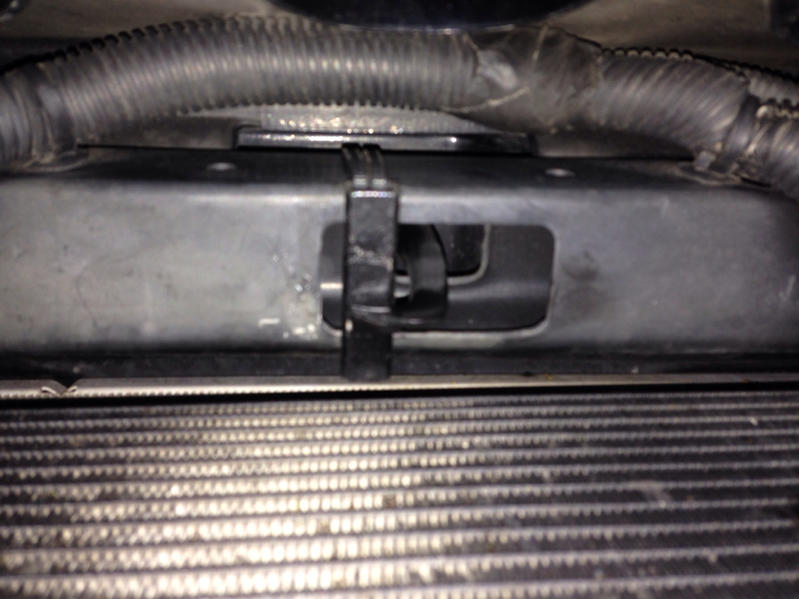

Two inches of 1/2 square tube and two wire zip ties. No more hood bounce.

I agree that removing the spring didn't do shit. At least not in the crazy Colorado wind.
