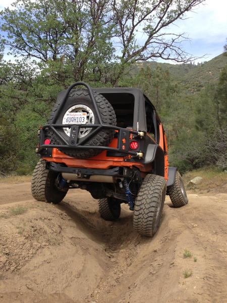

I run this set up with just front lower adjustable control arms and a flip kit

He said pretty clearly "bolt on" kit, as opposed to their full blown weld on kit. They (EVO) offer both systems.
Yep, bolt on coilovers.
http://www.offroadevolution.com/stor...od=EVO.Bolt.On
http://www.offroadevolution.com/stor...=EVO.Bolt.On.R

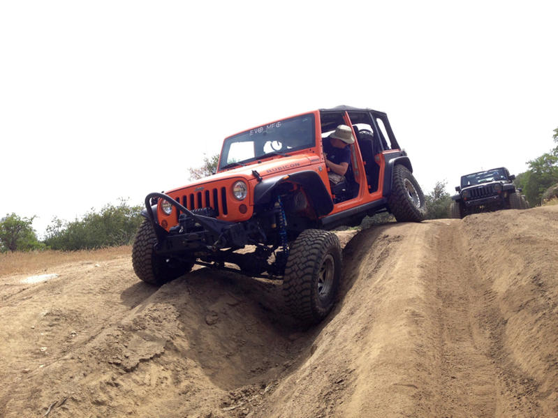

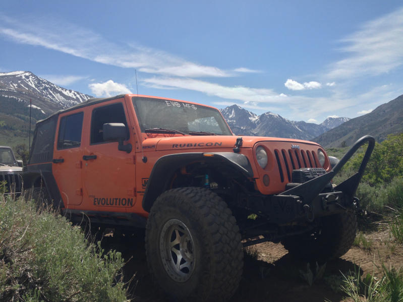

Shots on my JK
ID:	465302   Click image for larger version

Originally Posted by RubiconRon
Do the front come with reservoir king Shocks? It seems the back do. Also with bolt on coilovers why does one need air bumps? High speed woops? Also are the air bumps 100% bolt on?
By the way, I like the kit.
Both front and rear kits include King coil-overs. If you plan on driving fast the air bumps are a good idea. The front air bumps require cutting, and are bolt on. The rears will need to be welded.
