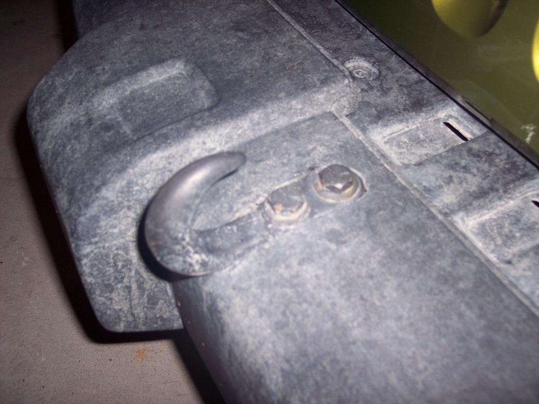

Yes, find some factory hooks (which you can probably find on jk-forum), unbolt the plastic bumper cover, cut out the holes, bolt everything back together.
I installed bigger hooks than what would fit at the factory points. I drilled my own holes in between the factory hook mounts. They've gotten a lot of use, but since they are inside the factory mounts they aren't supported as well and bend the bumper if I'm in real deep.
