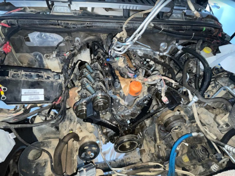

In regard to your previous more general "Jeep" issues, it does kinda stink that you've had to put some money into this, and some of the jobs just ain't fun. I'm glad you don't blame the Jeep. We certainly have a few common problems with our cooling systems, oil coolers, and valve trains. Add in suspension and steering issues that Wranglers will often have over time and these machines become a labor of love. I can tell you I have a love/hate relationship with mine. I've torn into my axles, suspension, cooling, and engine so many times in the last decade that I've lost count. This was the state of my engine this week -
