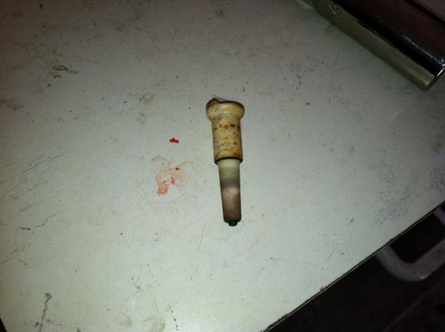

Just looked at the spark plug after turning the vehicle on, theres a lip in the interior wall, so Im sure when I turned the engine on the insulator/electrode blew out instead of being sucked into the cylinder. Thanks for all the help guys. jeep will be towed to a shop 4 miles away and they should have it done by tonight or early morning. I'll tell them to use antisieze on the other 3 I havent installed.
edit:
this piece that I found laying on the floor confirms that there's nothing in the cylinder head
Name:	spark plug 1.jpg

Yeah that was the first thing I was gonna mention. If the porcelain fell in the cyl, you're s o l. The head would have to come off. U got lucky on that one. Hopefully the extractor can get it out in one piece. Heli-coiling it would be a bummer. Hope it works out.
