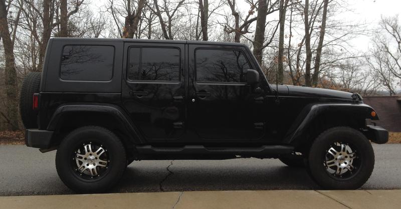

Default Done
Got it installed yesterday. Took my 3 1/2 hours by myself, but totally worth it. The hardest part was loosening the darn bolts with hand tools and getting the rear spacers seated. Hard to tell a difference in the pics, but in person there is definitely a difference!
BEFORE
Name:	My Jeep Before.jpg
AFTER
Name:	My Jeep After.jpg
Thanks for everyone's tips!
