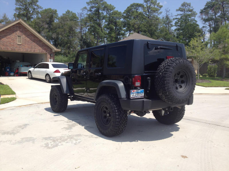

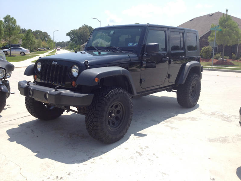

Thanks for all of the input! I went up to the dealership I used to work at and they let align my rig myself. Centering the wheel is what fixed the problem! Now to get it dirty!
Here is the rig as it sits now!
