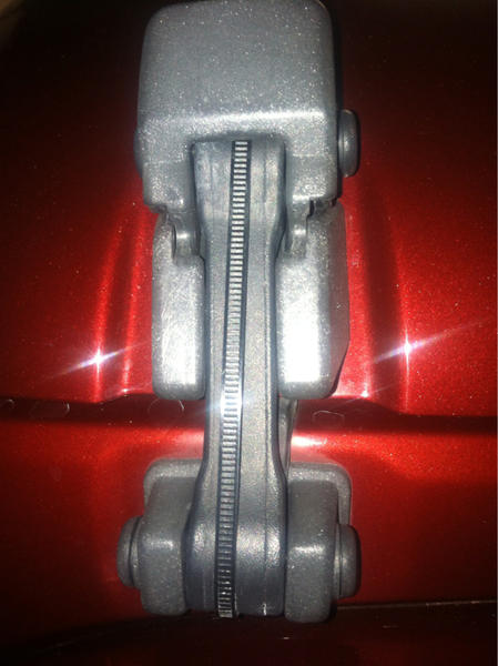

12" black zip ties. Will last a few years before needing replacement. In 20 years of zip ties they'll cost as much as Daystars.

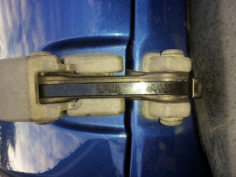

Big Zip Tie Mod is one of my favorites. Going on a year and still like the day I installed them.
Sent from my NOTE II on Sprint using JK-Forum
And here I thought I had done all the cheap/free jeep mods! Ditched the spring years ago, and I only get flutter these days if headwinds are excessive. But this is a great idea, thanks guys!

Zip-ties work great for me. About 120K miles with them over seven years, and had to replace one on occasion about three or four times. There is also the Brett Woods/JeepSWAG solution--a small piece of rectangular tubing zip-tied between the hood safety latch and its catch point in front of the radiator. He used to throw that in with most anything you bought from him in the past, but anyone could put one together for about a buck or so in parts (okay, more than that for the length of metal that would give you enough to make a dozen or more, LOL). It also works, and leaves the spring in (as do the zip-ties).

Originally Posted by Maertz
I did zip ties and in the sun here they didnt last long if you opened the hood alot. Took out the spring and it helped alot.. Now with my 18 dollar hood vents theres no issues
There are zip-ties that aren't UV resistant. Check the packaging.
