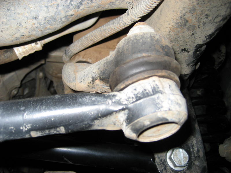

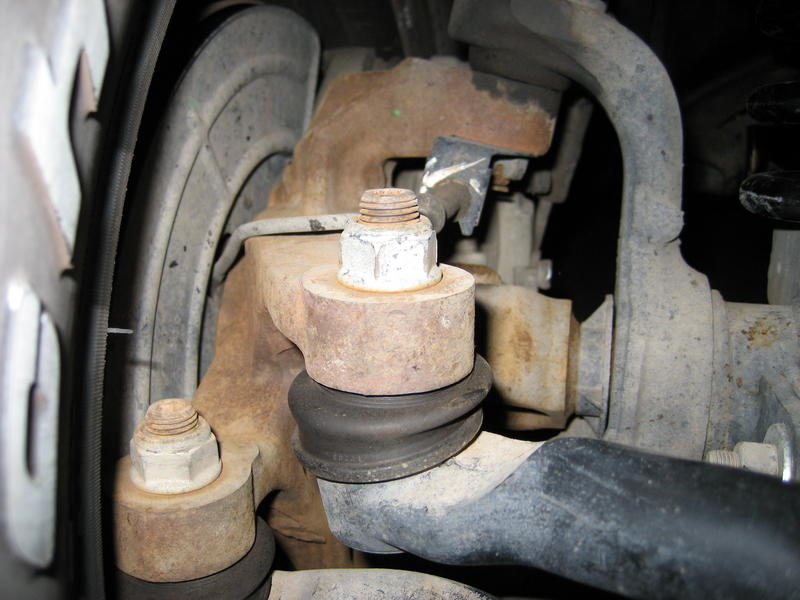

Here is the drag link end attached to the knuckle:

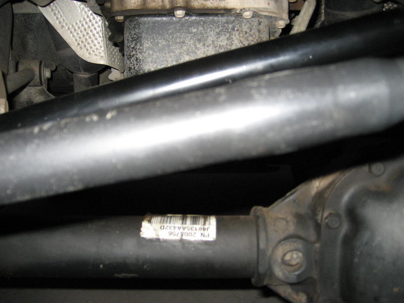

Here is the drag link end attached to the pitman arm:

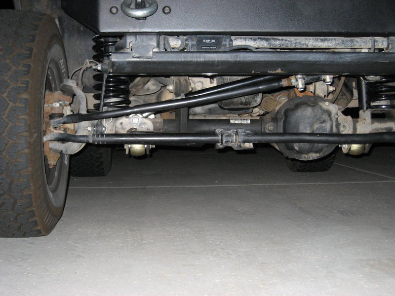

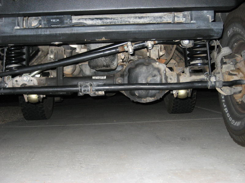

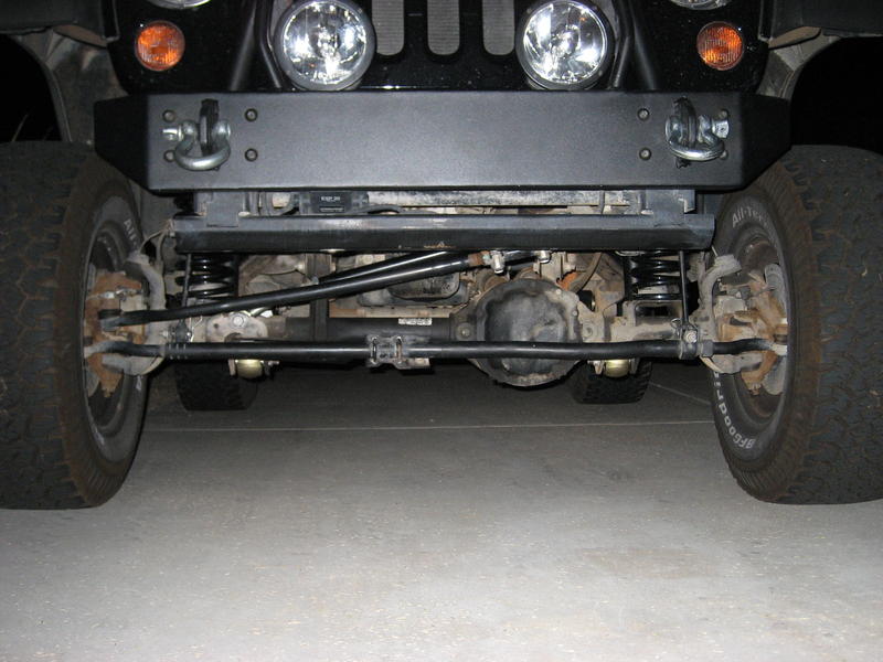

Do you have a pic from further back? You are looking for them to be parallel from mounting hole to mounting hole, which sometimes isn't easy to compare using the bars as there are bends in them.

They don't look close to me at all. But like someone else said. Without seeing the whole front end in one frame it's real hard to tell. Also flipping the drag link could make it worse.

Not running any coil spacers. I would get a pic from further back but that frame-mounted skid plate is in the way. I got roughly 3.5" to 4" with the coils. I'll see if the mounting holes are parallel when it's day time (night now).

I hope these help...

Flipping the draglink may make it worse. But that is not what I suggested. I pointed to the EVO Kit which flips the draglink but also includes a axle side trackbar bracket which raises the axle side by three inches to correct the geometry.

Looks like your drag link is bent. May be some funky angle or the lens but looks bent to me. Look that way to anyone else?
