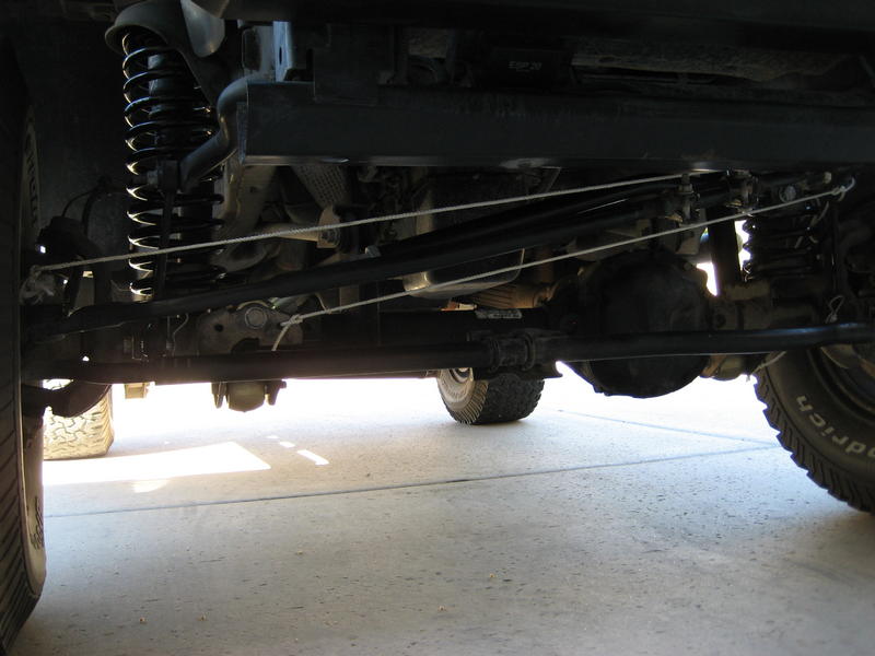

Originally Posted by planman
Just your end is bad. The knuckle is fine.
Your handling would improve with a flip kit. However, there is a minimum amount of front extended bumpstopping required to run a flip kit due to the change in position.
From your pics, you appear to be running stock front bumpstops (no extensions on the lower spring pads).
Before you consider a flip kit, you need to find out from EVO, AEV, Tefaflex, Rock Krawler, etc., how much front extended bumpstopping they recommend to run their kits. They might suggest a minimum 3" or 3.5" front extended bumpstops.
You may not want to restrict your suspension up travel that much.

Old Dec 12, 2010 | 10:00 AM
RN M OVR's Avatar
Joined: Mar 2009
Posts: 1,047
From: Scottsdale, AZ
Default STEERING GEOMETRY image
I don't know how much this test with some string helps. I know the string is not perfectly where the mounting points are for the drag link and trackbar, but hopefully those with a good eye can help me. I did this test in order to help out my bump steer problem, which I am trying to solve -- also debating if I should do a drag link flip or just purchase a new, stronger drag link for the stock location... looks as if I don't need a drag link flip kit. But I'll let you all decide as I would rather be safe and comfortable than dealing with wheel-wobbles when hitting potholes and cracks in the road.
Planman, feel free to put in your .2 cents.
Below the Knuckle:
Above the Knuckle:
