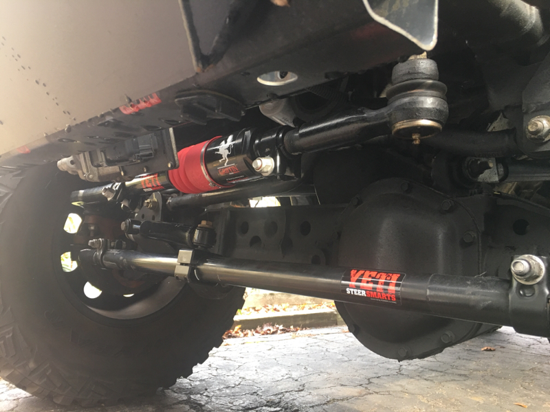

Steersmarts drag link and Griffin ... Trust me.
