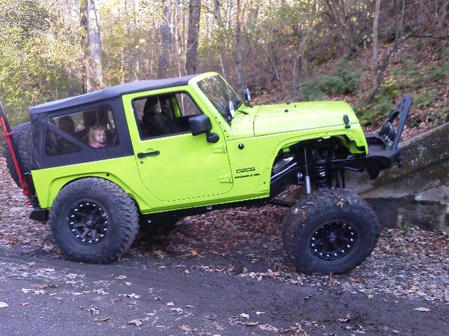

Old Oct 21, 2012 | 01:59 PM
mikd's Avatar
Joined: Sep 2009
Posts: 424
From: ny orange cty
Brand new base jk with all stock arms, just disconnected and 2.5" coils. Flexes pretty good for very little work. Minimal trimming on body for 37's, fenders were off for checking clearance.

Old Oct 21, 2012 | 02:05 PM
defierro's Avatar
Posts: 74
From: El paso, texas
Sweet rig! I didnt't specify. I need more flex in the back, the front is pretty good.
