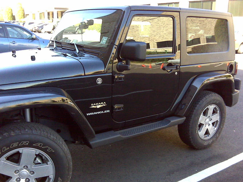

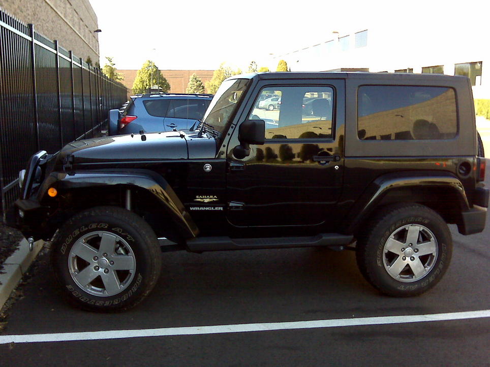

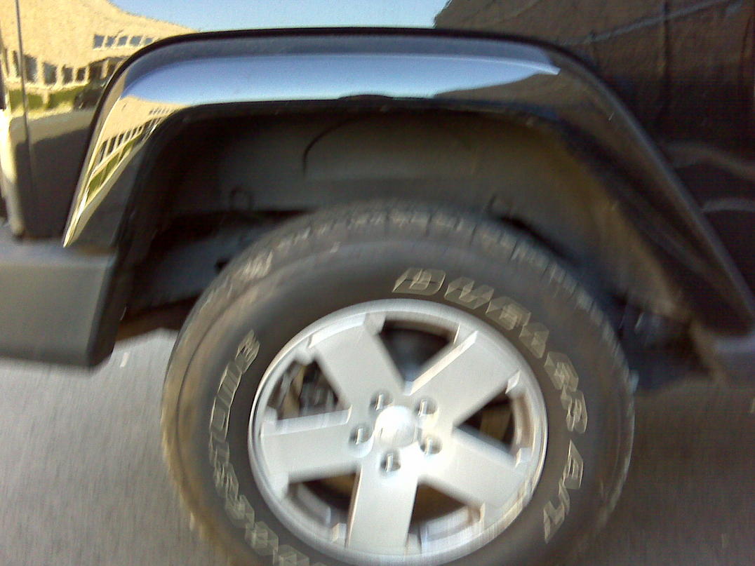

Here are some pictures
ID:	14524   Click image for larger version
ID:	14525   Click image for larger version
