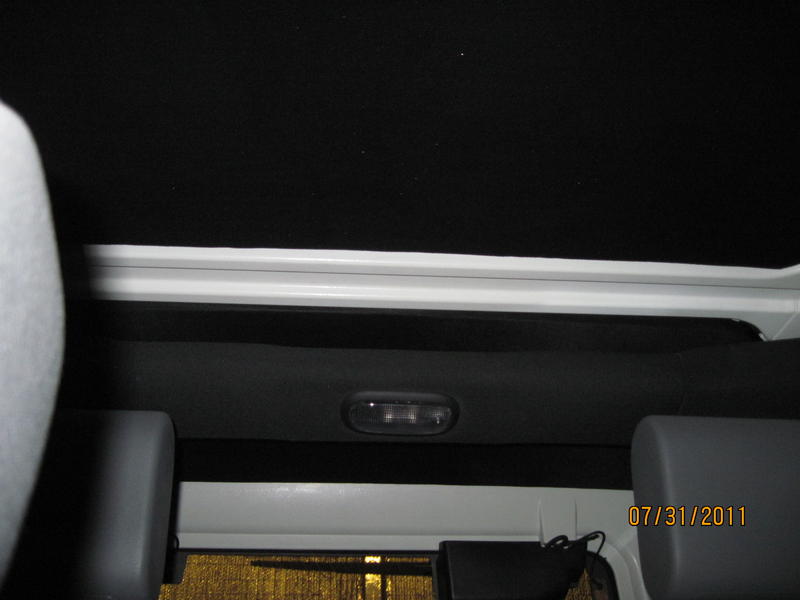

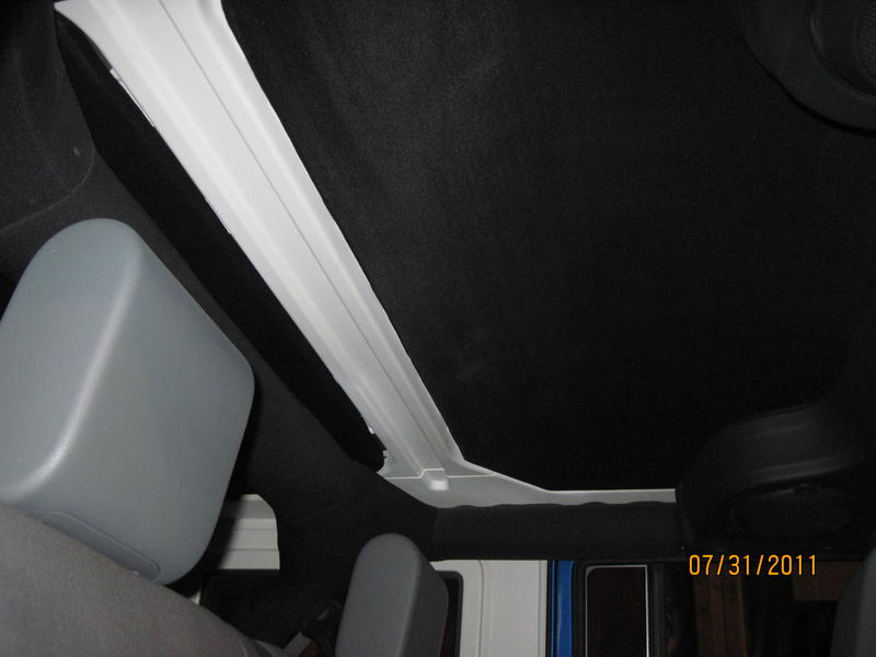

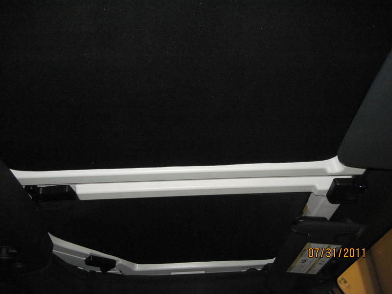

Last summer we set a record for the number of 100+ days and my ac was struggling to keep it cool so I decided to make a custom headliner. I'm glad I did it, this year I have been running my ac at half the blower speed and it stays cool. And I don't feel like my brains a slowly being cooked by the top. This may not be your issue but it certainly can't hurt looking into it.
