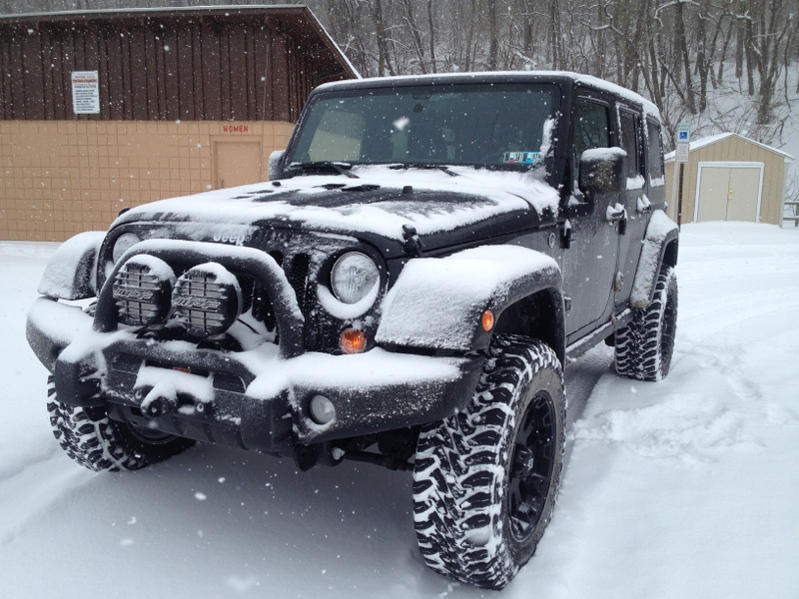

My 275/70R18 (33x11) Toyo OC M/T's (9" wide XD Misfits 5" backspace 0mm offset) sit right a the edge of the fender. The shoulder of the tire protrudes beyond the fender and throws road debris all over the side of the Jeep. Your 5.5" BS should produce similar results, although you might rub your sway bar with the wider tires.
