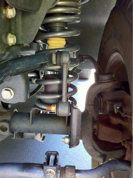

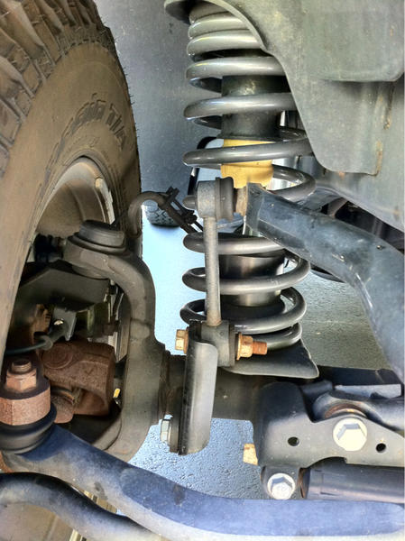

Does this look correct?
The passenger side is always on an angle where the drivers side is 90 degree. It's an AEV 2.5 lift with correction brackets. Thanks for looking..

That can't be right.. I have the aev 4.5, but if I had It bending like that then I would be getting it fixed ASAP.

Are you using the stock track bar? If so, any drop bracket with it? Maybe your axle is no longer centered, causing you link to lean slightly.

Looks like the bracket its bolted to is backwards, turned around 180 deg. Not sure how it would get that way?

It looks like they sent you two of the same side.
I agree ; your sway bar bracket on the left is installed backwards.
