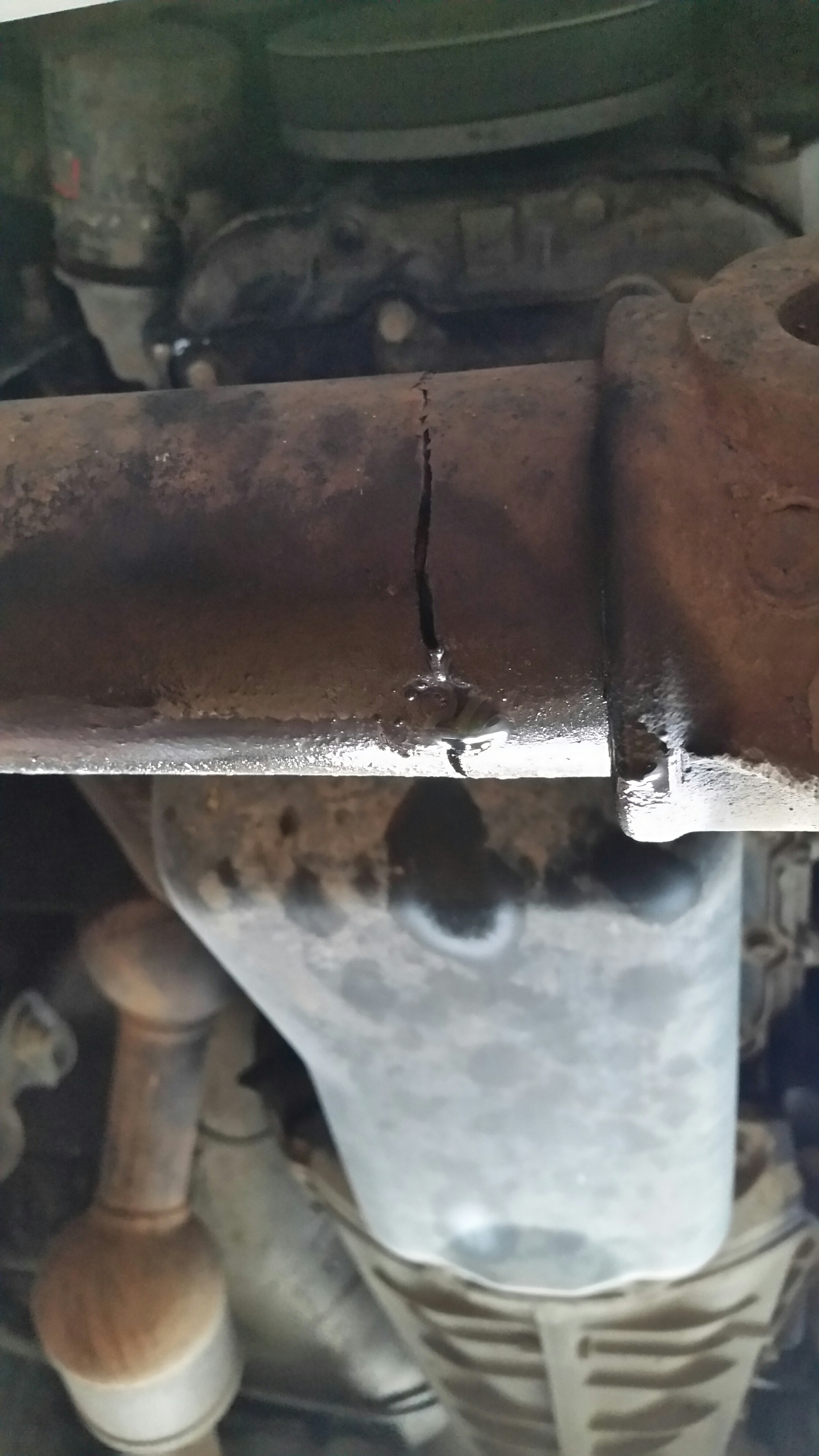

Originally Posted by TweakJK
I cant tell from the picture, but is that a plug weld for the sleeves or just a drip of gear oil at the lowest point of the break?
What you see is a plug weld for the sleeve.

I suppose a JK Dana 44 take off might be an option but isn't it's axle wall thickness the same as the Dana 30's?

That sleeve may be the only thing that kept your housing together. Without it, might have ripped it completely apart.
The only difference between a D30 and D44 housing is the cast center section. Everything else, tube thickness, etc, is the same. If your insurance or the city covers this, I would forgo a Mopar replacement and get a Teraflex 44 housing or some other housing that will take all of your stock components. Unless you wanted to invest in all new innards.

Originally Posted by ShutterBug
That sleeve may be the only thing that kept your housing together. Without it, might have ripped it completely ...
Good point. That would have been exciting.

Originally Posted by dan3jeeps
JK on 35's. Front Dana 30 tube is sleeved.
Yesterday driving down the highway through town at posted HW speed of 60 mph I hit a new pothole or road crack and BAM! Jerked my JK around and even knocked the tranny out of gear. I get home and find this:
Attachment 660293
Lube all over the driveway. Axle cracked wide open.
Now... can this be repaired by welding the tube or is this going to take a new axle? I know a new Tera 44 or something is the cat's meow, but do I have other options?
A D30 with 35s on it is a ticking time bomb. The housing is just too weak to live with that. Could you repair your current D30, yes, but you would just be wasting money as it would break again at some point in the near future, and you might not be so lucky the next time to escape without damage to the rest of your JK.

Tera Flex has a Dana 30 replacement axle. Much better built than stock, stronger, beefier, set up for lifted JKs...
Other than a bigger/stronger ring and pinion in a TF Dana 44 is there a good reason NOT to get the TF replacement Dana 30?
My wheeling is mild, no mudding, no extreme rocks. No locked different either.
A Dana 30 is still a Dana 30, even an aftermarket one, and still has the inherent weaknesses of the overall design. And what you'd spend on that aftermarket Dana 30 wouldn't be far from an aftermarket Dana 44-based housing, so why not do it right the first time and get a 44? And if/when you decide to step up your off-roading a notch or two, you won't have to worry about whether or not your front axle is stronger enough to handle it.
