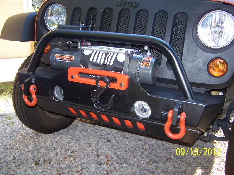

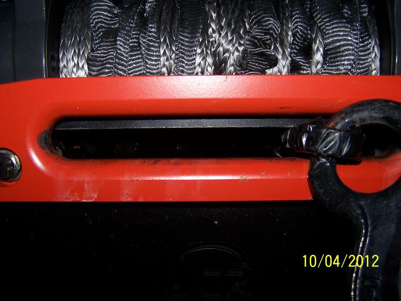

Here is my problem..

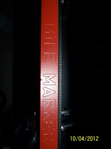

Now that I've had a chance to look at it this morning, it looks like I can flip it "upside down" and make it work...even though the way I have it mounted is the way it was intended to be mounted with the Milemarker name on top. Not a big deal, the mounting holes on this particular fairlead just aren't centered top to bottom like most others.

Heres a better pic to see how the mounting holes in this fairlead are "low" instead of centered...just something for those looking to run this combo to look out for.

My bumper and fairlead are definitely not compatible. I tried to flip it over and all that does is make the part of the bumper that intrudes, intrude from the bottom instead of up top. The holes in the fairlead aren't centered and thats what I need.

Man, what the heck! I don't understand why they made their fairlead this way. This is going to be a problem with 90% of the bumpers on the market!
Defiantly not going to work. For anyone that has this combo in the future, we'll have to add this to our site!
