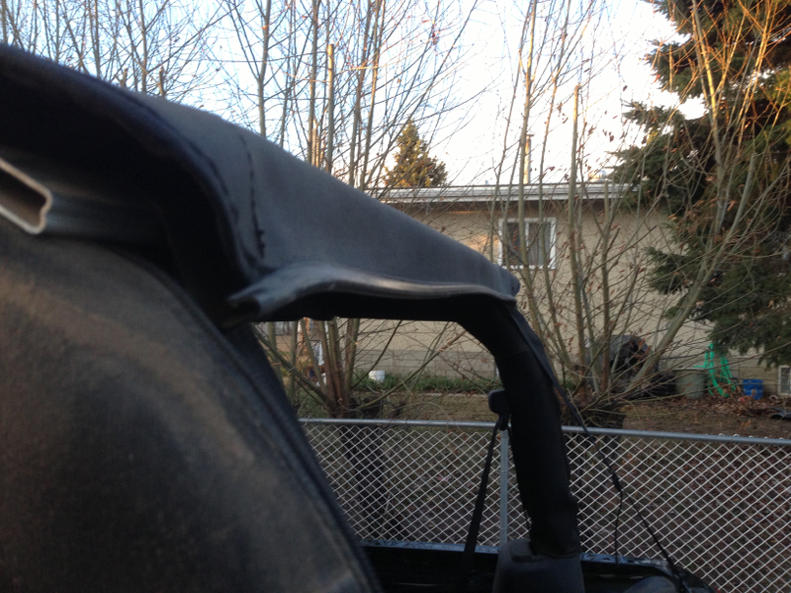

Here is picture as promised

Looking at the photo it appears you are missing the two metal clips that attach to the role bar. The aluminum channel slides into the metal clips to prevent it from flapping.

Can u post a picture of said clips? I never realized I might be missing anything
