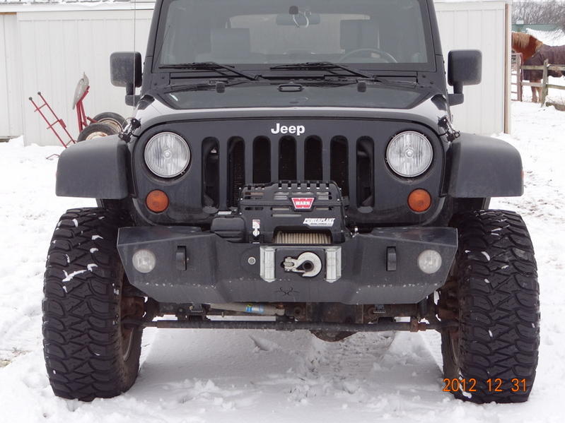

I have been involved with HEAVY rigging for 25 years synthetic rigging is FRAGILE it has its place, but I have yet to see synthetic rope on a crane. I am not by any means knocking synthetic rope I just would not throw a good wire rope to rush out and buy synthetic. As for Warn winches they are like my Freedoms arms revolver, everybody compares themselves to them. I do love the built in compressor and no one else has it.Click image for larger version
ID:	416720P.S. at 12,000lb. line pull I havent pulled anything that even started to slow it down.
