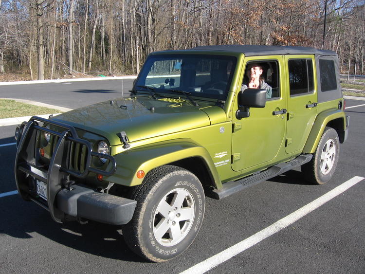

I am putting in a 1.75" front coil spacer and .75" rear coil spacer to level out my jeep. I have a large push-bumper/grill guard that is pretty heavy and wanted to stack a .75" front coil spacer on top of the 1.75" front coil spacer mentioned earlier to eliminate rake. All spacers are from the same manufacturer, is this possible/ safe? Thanks in advance.

Get with RC or Teraflex, they make 2.5in spacers I believe. Same difference with no stacking.

I also am adding a bumper, the weight is about 140 pounds. I have been told that the front plastic with bumper weighs about 35 pounds so the net added weight will be about 105 pounds. I was thinking of doing 1 3/4 spacer up front and 3/4 in back. My goal is to fix the rake/drop from the added weight and also give it a bit of a boost.
My questions: 1. Will this work, or is there a better way?
2. What brand of spacer should I go with??
Thanks!!

it sounds like it should work, I have that same set up in my jeep on top of my lifted springs and it worked. as for brand of spacers I would just get the cheaper ones, there is not much science on a bunch of pucks. my friend used tj spacers up front and they worked just the same.

With just the ARB bumper I am about 1.5" lower in the front than the back. That is probably about .75" factory rake plus .75" because of the bumper. If your bumper weighs the same (probably similar) and you add 1.75 in the front and .75 in the back you will net 1 inch in the front which will bring you pretty close. Personally I would like to keep some rake because you do get better mileage and less wind noise and .5" is not that much of a difference when you look at it.
