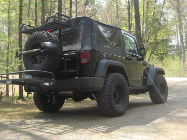

you really dont need to lift it . if you go 33s . i love my set up stock with the rancho 9000 adj shocks and 33s gets the job done with ease . If your bent on 35s yeh but for most hunting areas being logging trails you dont need 35s or the lift. put that cash into a new bow or guns
Love that bumper rack. How do you open the tailgate if there's a cooler back there or something

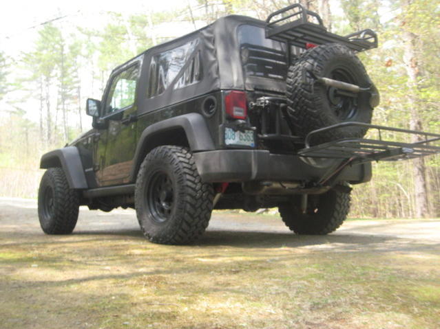

course having a cooler on there chances are you wont need to go any further till empty ( It attaches to your 2" trailer hitch receiver not your bumper)
I leave mine on all the time , you never know when your gonna need it. It dosent get in the way. Click image for larger version
ID:	610875 it offsets up so you dont hit shit on a trail or anything
unless you drop off ledges i dont play on big rocks i cant afford the damages ..
