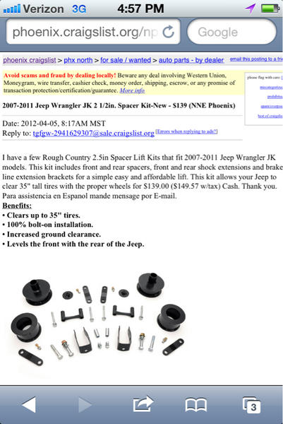

I'm on the same boat, this is our dependable vehicule, but I hate the way it looks stock, this is the kit I bought, and i plan to get 33's for the stock rims but I'm also nervous to instal, don't want to ruin the smooth stock ride..

Most everything I've read states that the ride will stay basically the same maybe just a little stiffer. Wondering if there are additional parts that I need or if this kit contains everything.

I think the kit is complete, I'm keeping my stock shocks, maybe down the road I'll upgrade..
