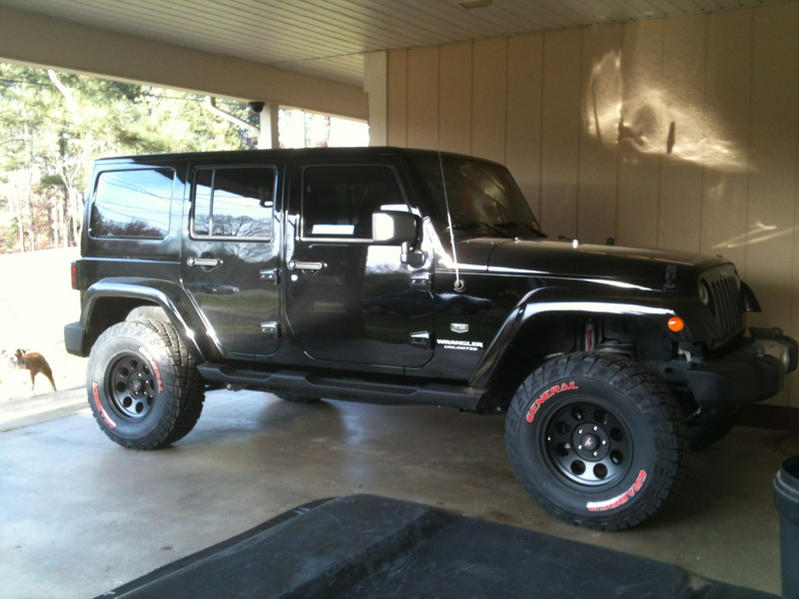

I'm running rough country 3.25 n 33 n I love it
