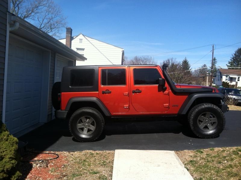

I just installed the Rusty's 2" coil lift with shocks and its great. It rides better than stock and clears my 35" bfg a/t's. I still need to get wheel spacers because the tires rub when I take a sharp turn. The kit was real easy to install. I did it by myself in about 4-6 hrs and I'm no mechanic. The only issue is the shocks dont come with the bushings installed and the rear shocks are tough to get the bushing in. Do yourself a favor and have a shop press them in. I spent an hour trying to do it, my local meineke did both of them in 20 minutes. I gave the guy a $20 and he was happy. Oh btw the Rusty's kit is really affordable to and a US company.

Zech80 how about a pic.. love to see what you've done.

I know its a driveway pic but I just did the lift then I ripped out the dash and Im waiting for my new Kicker speakers.

Awesome.. that's a great looking rig. Hope to get mine up to snuff in the next six months. Money......... kids, mortgage, food, school.. gotta save my coin.
