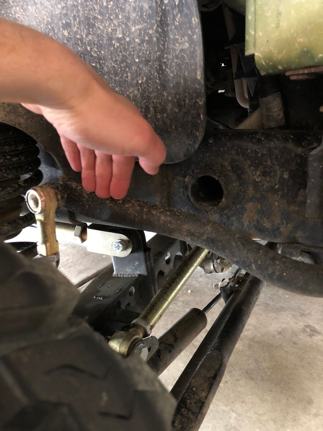

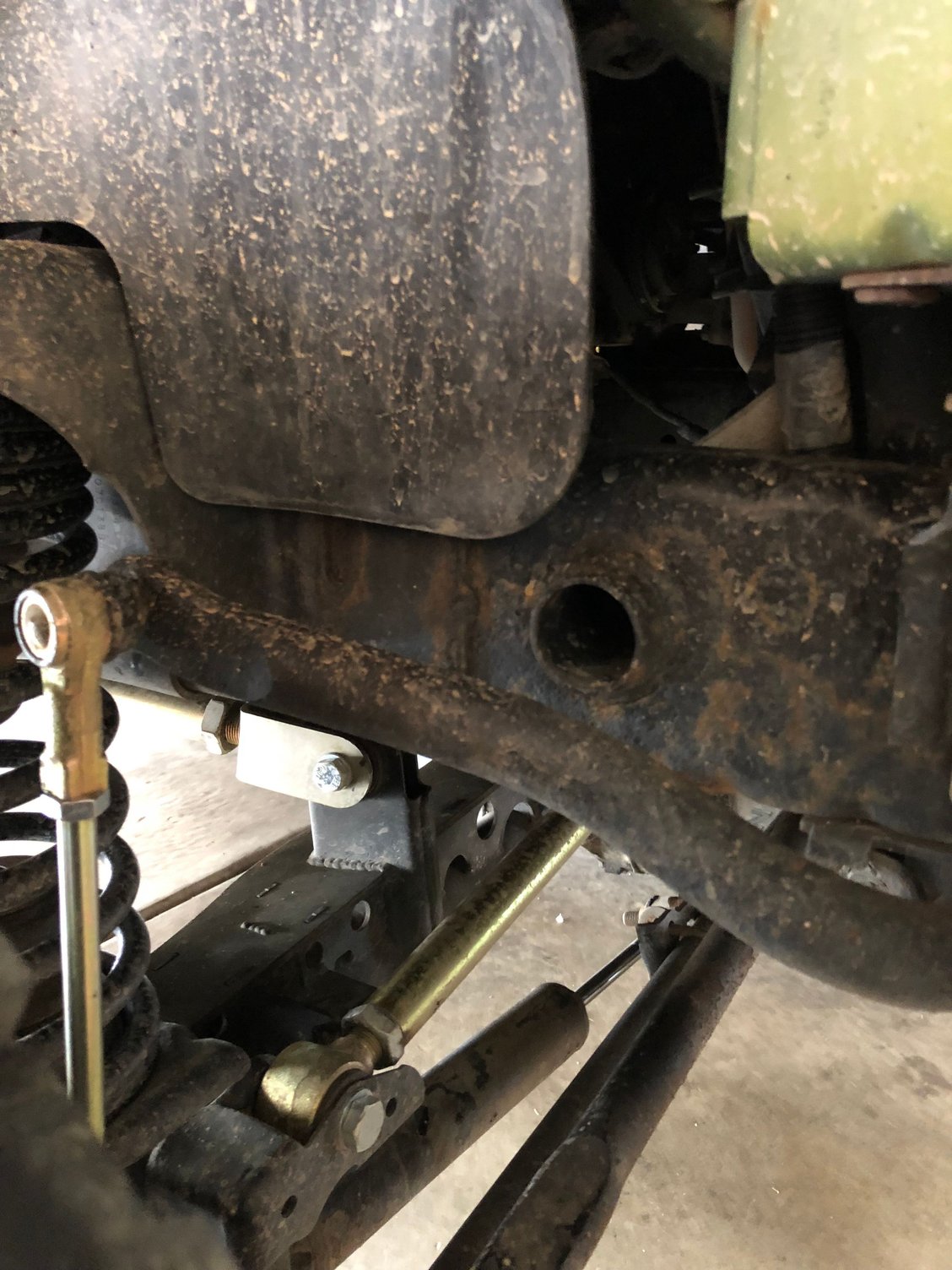

Still had to cut that bolt Karl. Not a big deal dremel made short work of it. The only major snag I ran into was lower control into axle brackets. The MC bushing was too wide to slip in with out massive persuasion. I chose not to persuade them into the axle and had them machined down to slip in a little snug.
One thing about MCs front sway bar links is the sway bar does not sit level. It sits high. I thought easy fix. Just cut threads to length. Called MC to be sure they said don’t!!!! They are worried that the sway bar would flip down if cut. -shrug-
Here’s the finished product. Loving it.
Better too high than too low. Is it angled up more than a couple degrees? Looking good! Time to tackle some larger rocks!
iPhone inclinometer says -16 degrees. No issues handling.
