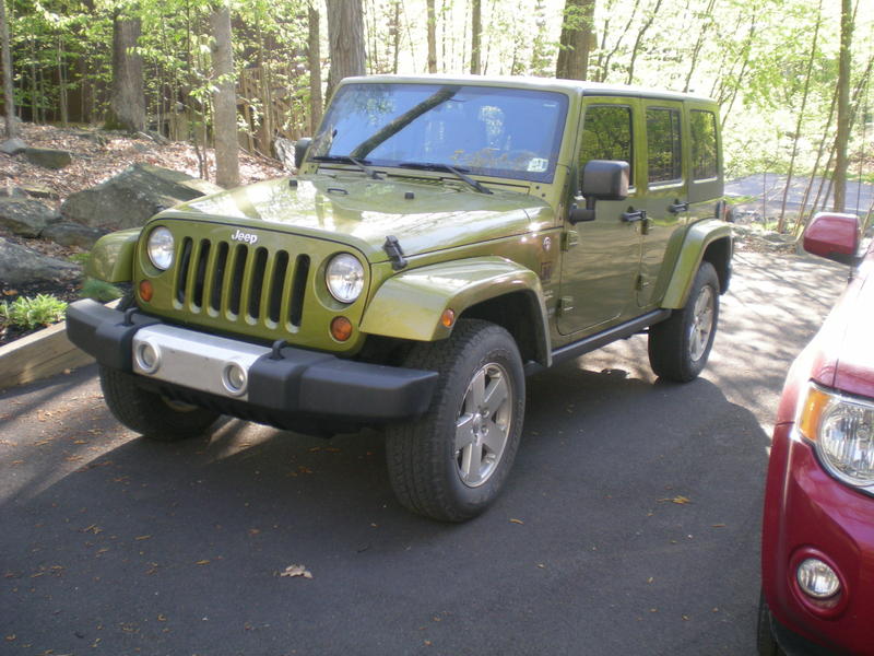

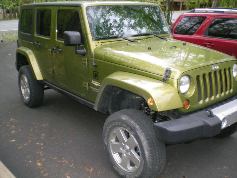

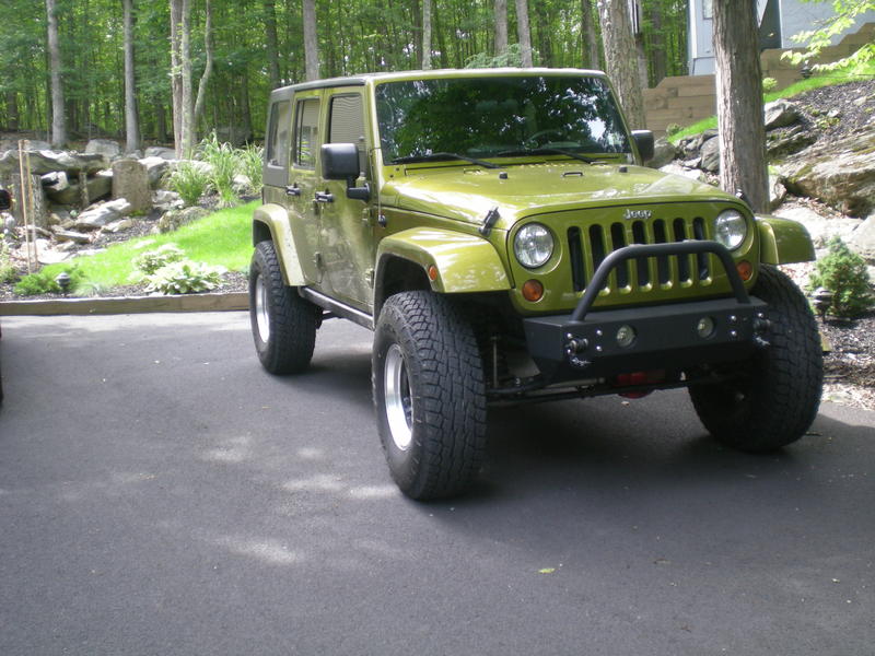

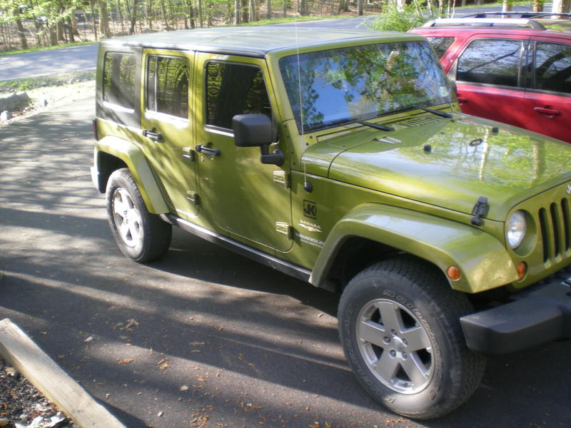

Want a complete kit? Take a look at trailmaster's 4.5" kit with shocks and driveshafts. Contact Yates Hudson on the forum here and he can get you all the info you need. It is a complete kit that will get you plenty oflift for 37s. I know because I'm running the kit with 37s.
I love it, it rides great, handles great, flexes and performs well. The kit comes with basic SSV shocks wghich are...alright. They do the job but in the spring I'm going to upgrade to something much better like Bilstein, Fox or Elka.
The kit has everything you need to lift your JK a full 4.5", safely and functionally. I did beef my front axle when I did my ring and pinion swaps to ahndles the 37s. I don't wheel hard but feel that you can't go wrong with overkill. The install was simple, everything lined up and installed as expected. Kit has all 8 control arms, quick disconnects for the front, adjustable front tracbar, rear tracbar bracket, bumpstops ext. stainless brakelines, springs, shocks, steering stabilier relocation bracket, and driveshafts. I might of left a piece or two out. The nicest thing about was that the measurements given to set your arms center the rear axle in the wheel well, so no trimming of your pinch seam to run 37s.
Here are a few pics of mine.

Here is a few of mine before and after.
