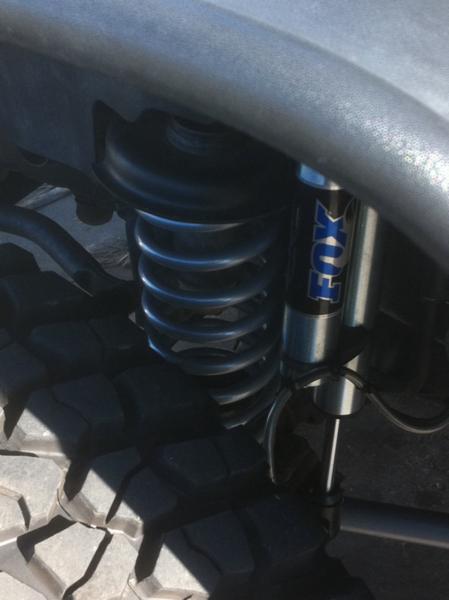

I just want to eliminate the chance of a oversized slinky from rolling down the trail and to protect my new shocks.

Don't have pics and I don't have them yet The straps are primarily for saving your shocks. And some people use them to help keep their springs in place. If you have invested 800 bucks in a pair of nice shocks it's more like cheap insurance to make sure you don't have all the weight of your axles when disconnected sitting on your shocks. I am running a triple threat long arm my RK and at full flex with my fox reservoirs shock the spring is very loose. I'm not worried about the spring as much as I am damaging the valving in the shocks. And that's the point in limiting straps. And in someones case on this thread if your not disconnected and your springs are still loose then your shocks are way to long for your suspension setup. IMO. I'm sure some would agree and some would disagree.
Where did you install your straps? Did you weld on tabs , or just bolt them to an existing bolt. I heared people just run them to the shock bolts

I don't have them yet. So I'm not sure what I'm going to do but I can tell you I won't be bolting them anywhere near the shocks. Those things are my pride and joy. And I can't have them even scuffed up. I think I'm going to find a nice location on the inside of the framerails behind each spring and weld a braket in there and on top of the axle. Flex it out to my desired length and measure what length I want to run and order them.
Haha. I know what your say'n Resivor shocks are sexy as hell. But if you wheel it they might just get scratched up.
