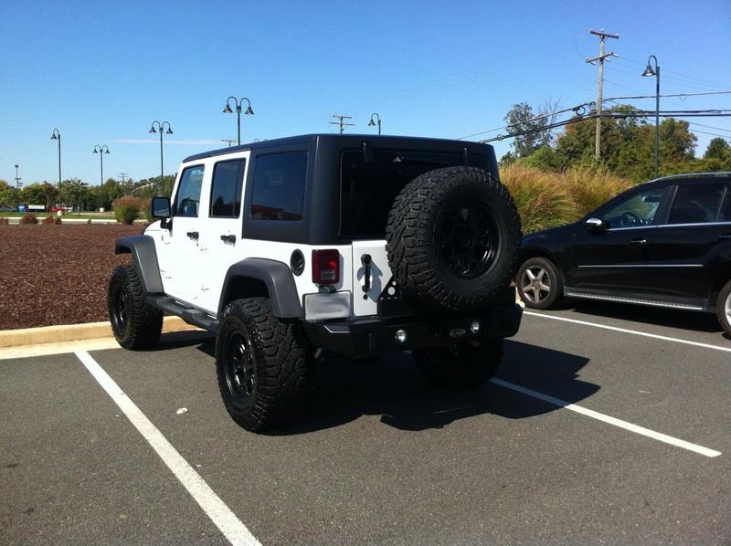

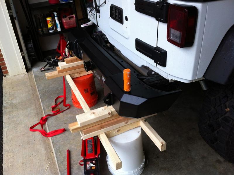

I have the shorty, which from what I understand is about 20 lbs. less than the full, and that thing was no joke. I had a friend help me get it on and aligned to mark the holes, then I had to roll solo to get the bumper back on after I drilled, and I'm pretty sure I almost died twice. I ended up jerry rigging a stand with 2x4s, homer buckets, and a floor jack to get finally get it back in position. Lesson learned...use the buddy system when installing these bad boys. God help me when one of the lights goes out.
I ran my electrical up through the driver tail light cavity and into the jeep, under the carpet and out to a switch unit I have installed under the hood. Wiring was pretty straight forward, but the wires included weren't long enough so I had to splice. Overall really pleased with LoD. I was missing the grease fitting as well, but Chris promised to send me a new one. I have the shorty on the front as well, and I'm waiting for the rails to come.
Here's some pics.
