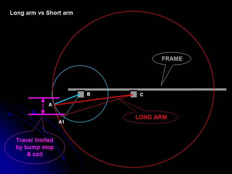

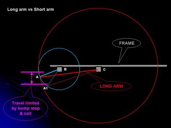

This is what I mean regarding the benefit of long arms for taller lift:
Name:	Long arm vs Short arm - 4 vs 8 inch.jpg
If 'A' represents 4" lift, the short arm would behave nice enough to not give a long arm a meaningful edge.
However, if the lift is doubled to 8", the the short arm now has to go down to 'A1'. It is too far from horizontal.
The axle is drawn back too much.
In this case, of 8" lift, a long arm would be a must. It will have a smaller angle relative to the frame, and the axle wouldn't be drawn back so much.
For most of us, there's no need for more than 4" lift, and short arms are perfectly good for this lift, provided that everything is tuned right.
(But then, everything should be tuned right for long arms as well...)
