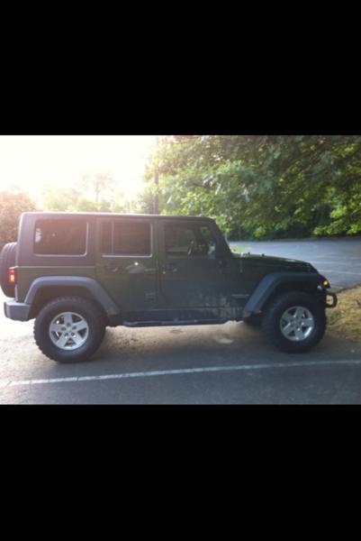

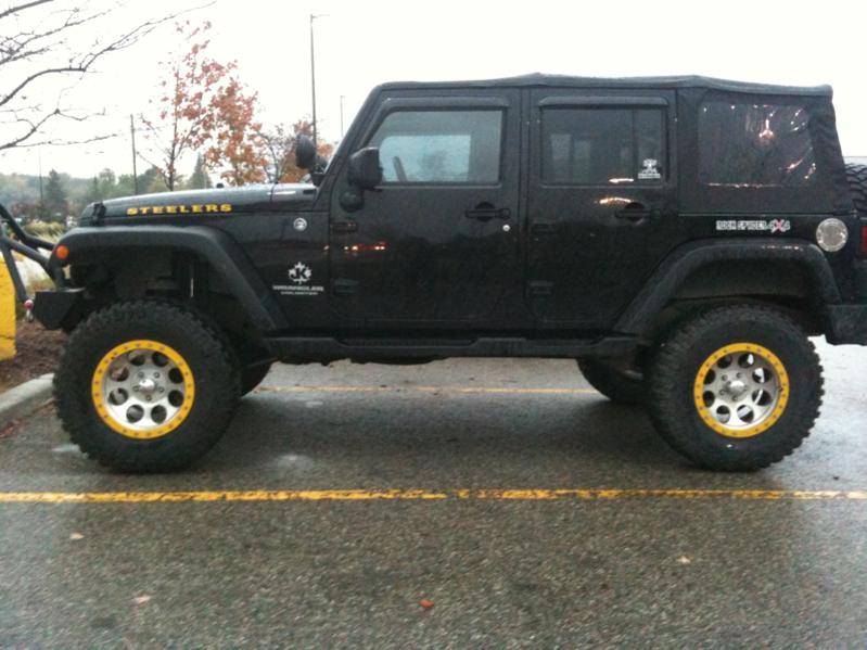

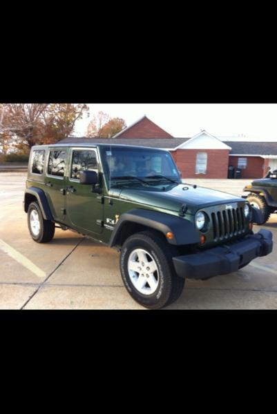

Tons of info on lifts on here. I have a rough country 2.5 suspension lift. Came with coils, shocks, rear track bar relocation bracket. It's thought of as a low end lift. It works and better ride than stock. Fits 35"s. was $300-350.
If you got the budget a TeraFlex seems to be very popular. About twice as much. Seems like most kits come with everything you need. 2.5 lift is usually the easiest lift to fit 35" and to not have driveline issues. Some folks will tell you that if you have the budget go taller. Do some searches. Look at pics and get what you want.
Before and after.

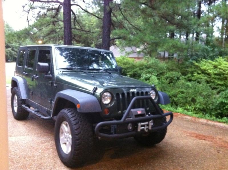

I just put Full Traction's 3" Ultimate lift on my JKUR and I love it. Actually this is my 2nd FT Ultimate lift. Had it on my 07 as well. It's straight bolt on an very easy to do and the instructions are actually really good. It's a great size for running 35's. Also they have options between the ultra, premium, and ultimate depending on what you want to spend. It's all the same kit but one comes with lower arms, the other upper arms and the ultimate is both.
Can't say enough good things about them and Chris at FT was very helpful getting me what I needed. Keep in mind at 3" you will need to swap you front driveshaft if you're taking it off road. At full droop the stock shaft will hit the exhaust. If you aren't going to be doing trails that need full articulation you might be fine.
Almost forgot to mention you can get the FT lift with Bilstein 5100's.
Hopefully that all makes sense. If not I blame the beer.
Heres my before and after:

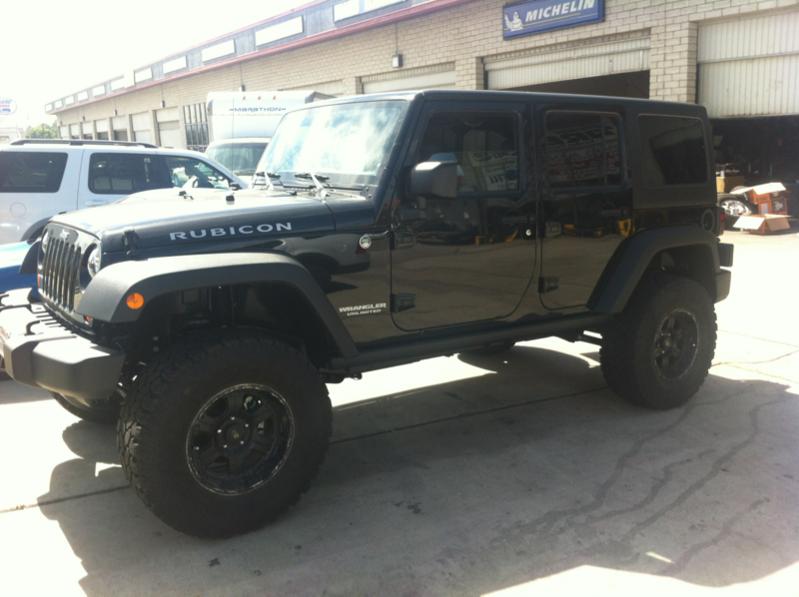

I have the 3" teraflex coil lift with the 4 flex arms...... I added a beefier track bar and steering stabilizer. Gave me almost 4" I believe I added spacers/ pucks to level out my front end.... On 35" Mickey MTZ tires
