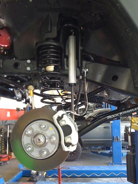

Originally Posted by jksooner
I spoke to you before about lifts and you seem to know a lot... I know for 2012 they changed the tranny... Do you know if the drive shaft and skid plate have the same issues as the 07-11s?
No they don't have the same issue. I have a 2012 JKU Rubicon auto with a 3.5" Rock Krawler X-Factor Mid Arm Suspension. The stock driveshaft clears the auto transmission, but it will hit the exhaust crossover pipe. I bought an aftermarket driveshaft that cleared the exhaust by about a quarter of an inch when the Jeep was on the shop rack and the front axle was at full droop. I didn't feel comfortable with that little bit of clearance, so I also installed the aFe y-pipe to relocate the exhaust crossover. Now if I go to a long arm kit in the future or get some extreme articulation with my current suspension, I won't need to worry about clearance issues with the driveshaft.
