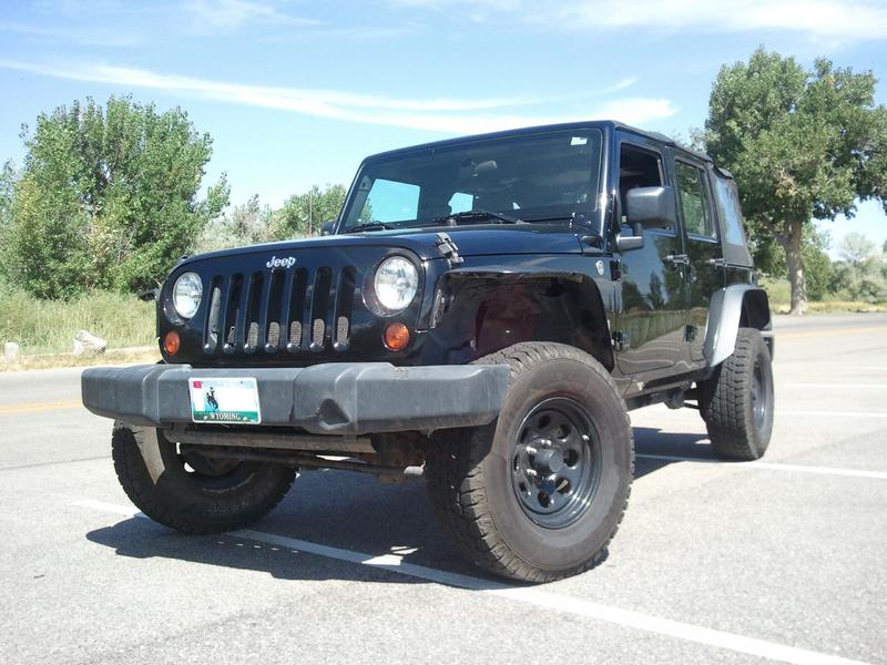

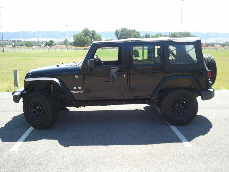

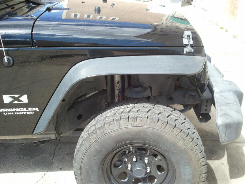

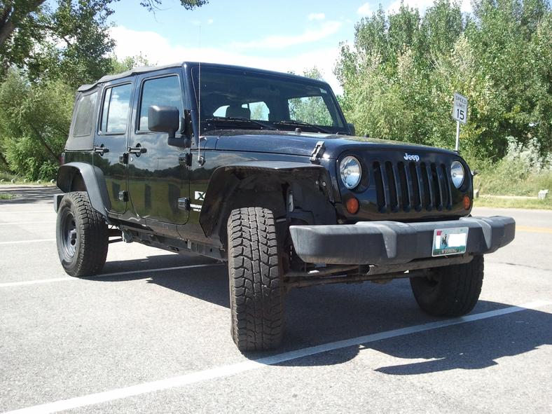

I was in the same boat (wanted to still run the front inner liners), so I trimmed them up with a dremel where needed (I kept enough up front to use the original body clip placement) and near the rear of the front fenders leave yourself enough of the plastic to fold back to the body then attach them with either body clips, nutserts, and/or sheet metal screws (with any drilling, cutting, etc.. into the body, make sure you touch up the paint to avoid rust). To bend the plastic liners I heated along where I wanted the bend and once you get them warm enough they will bend/fold relatively easily and will hold their shape (notice I said warm not hot, you don't want to melt/burn the plastic). For the heating I simply used a charcoal grill lighter I had and it worked very nicely. Here are some pics (I don't have any close ups but can work on getting some maybe, right now it's 19° and snowing pretty well so might be tomorrow or later).
It's a little nerve racking at first, but if you have a steady hand once you do it you'll wonder why it took you so long to complete this mod.
Attachment 244001Attachment 244002Attachment 244003Attachment 244004
Good luck
I drilled a hole in the liner and body to run a zip tie through to help hold them in place after chopping them. Works great. I bedlined (Rustoleum) the wheel wells too.
