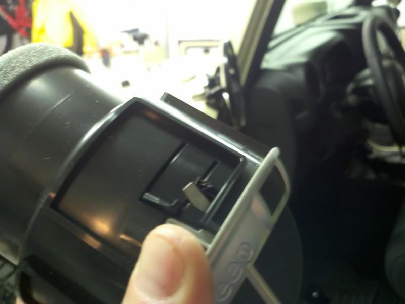

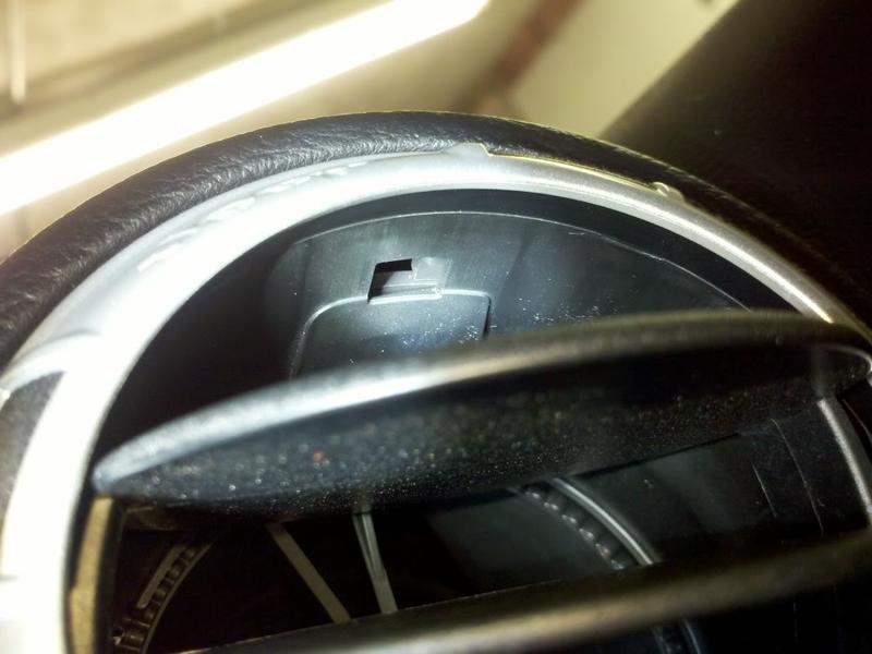

Originally Posted by soxkid
How did you get your vents to come out... been fiddling with them for about a week at stop lights to see if they would pull easily, someone mentioned a quarter turn of the difuser but no go on my 2011...
On the 2011 and 12's there is a little notch at about one-o'clock you have to insert a small flat bladed screwdriver in and pry gently down while twisting the vent counter-clockwise then out. (See photos)

That video was exactly what I needed. Thanks for posting it up.
With your 2011, you have to stick a screw driver in the vent at about the 1 o'clock position and then quarter turn to the left. There is a video on YouTube.
