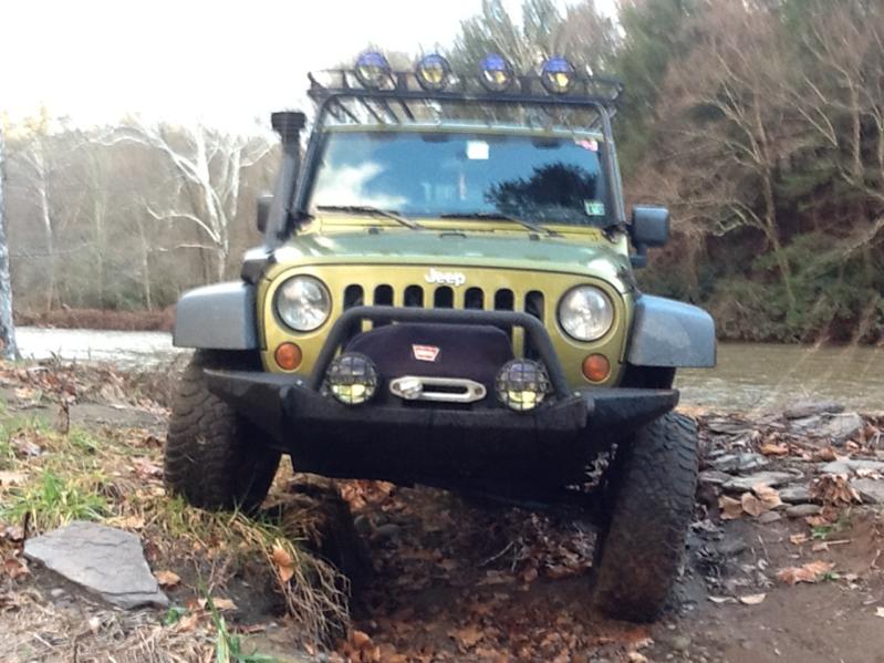

I'm wondering what i can do to get some more flex out of my suspension without lifting my Jeep any higher. Aka droop.
This is the current setup, let me know what you think the limiting factors are or what has worked well in your JK.
I find even with the front sway bar disconnected I'm not getting very much articulation. I know the HD springs are stiff but I'm curious what you all think is really limiting my travel.
Stock axles, LSD rear open front
OME HD springs.
OME Nitro shocks absorbers.
OME 2" bumpstops front and rear.
6" extended brake lines front and rear.
Sway bar disconnects in front.
Stock sway bar links in rear.
1.25" wheel spacers.
Stock Rubicon BFG tires and wheels. (35" tires pictured have been removed and replaced with stock ones)
ARB Bull bar and winch up front, spare tire and recovery gear in back.
OME HD springs.

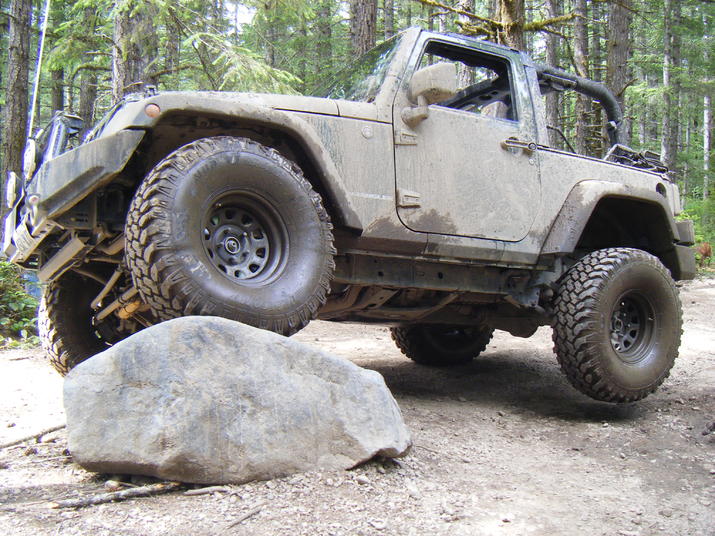

I may be missing something. I have the same set up, but Teraflex arms and no bump stops..I'm getting ready to buy those now... Wouldn't the bump stops be the limiting factor on your current set up?
I attached a pic of the flex I am getting now... I think I will be getting about what you are when I put the bump stops in for bigger tires.....
