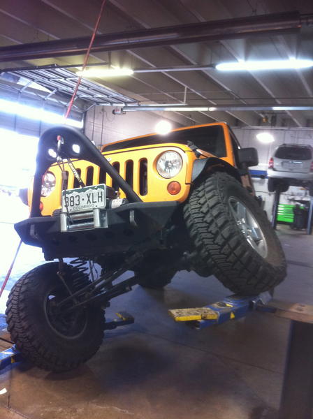

3.5 rock krawler. with armor, winch and bumpers settled to just under 3. Click image for larger version

Now thats some serious flex nacho, mind sharing some info on your set up?
You running articulated control arms?

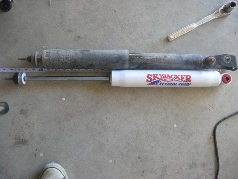

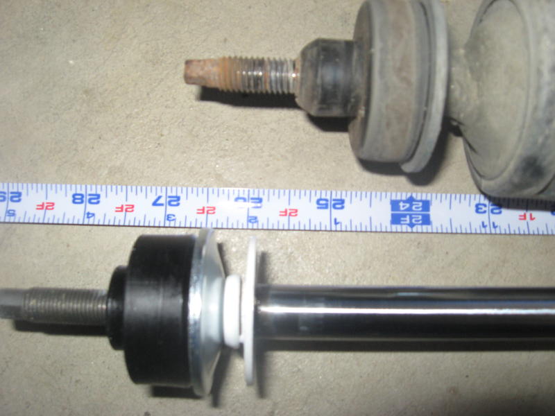

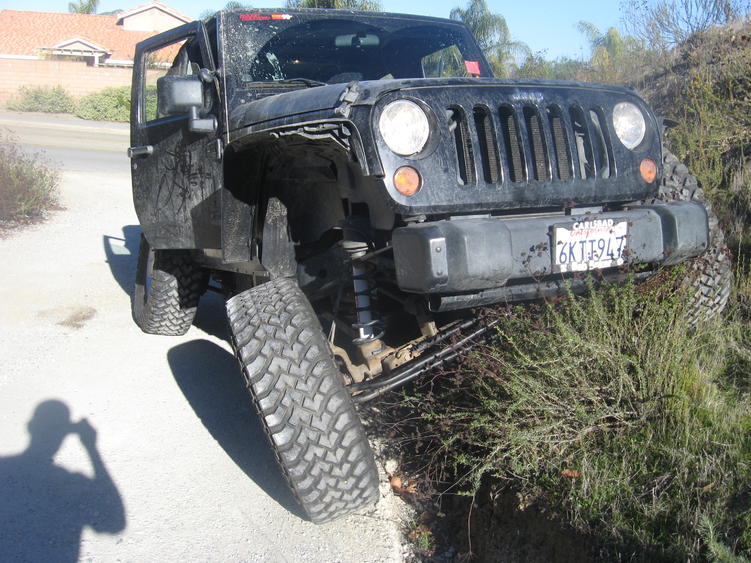

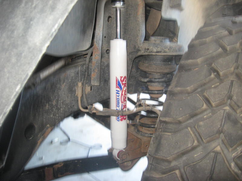

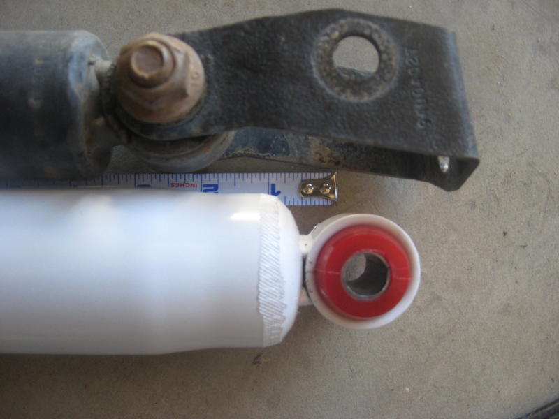

ID:	264206Click image for larger version
ID:	264207Click image for larger version
ID:	264208Click image for larger version
ID:	264209Click image for larger version
so i just got these shocks from 4WHEELPARTS i only bought the front two for about $37.99 each.
Softride Hydro Shock by Skyjacker
Part Number: SKYH7075
2007-11 JK Wrangler, Rubicon and Unlimited with 6" lift, front (I HAVE A 2.5" SPACER LIFT)
Collapsed length (in.): 15.56
Extended length (in.): 26.750
Shock stroke (in.): 11.20
i wanted to get the OME LT shocks but lets just say they weren't $37.99. i wanted to get shocks that were easy on the wallet and have similar lenghts as the OME LT shocks (Collapsed length (in.): 16" Extended length (in.): 27.50")
here are a couple of pics. im pretty sure im missing some details.
