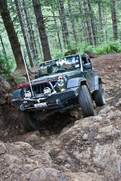

Cool!!! The guys at Northridge confirmed the standard OME HD coils I have will work with the OME LT shocks.
I do need adjustable track bars and lower front control arms. They're checking on the Rock Krawler parts inventory now.
The bump stops, discos and ss +6" brake lines I have installed will all work with the OME LT kit too.
Should make the installation pretty straightforward.
Once I get all the pieces together I'll post up some install pics and compare the OME standard vs Long Travel suspension flex.
Thanks for all the tips gang, makes me feel a lot safer mixing parts and brands knowing others have done it with good results.
It's always nerve racking to buy an incomplete lift kit or a new brand and just hope it all goes together smoothly.

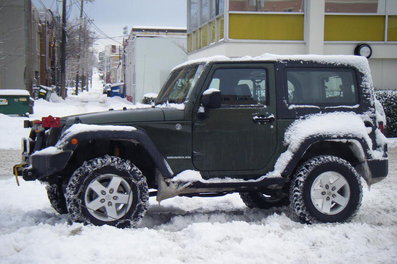

WOW, Northridge is amazing!
Shipped my OME long travel kit yesterday during a snowstorm, arrived TODAY during and icestorm...
Nobody has been at work the past two days. I'm #3 out of 400 peolpe that made it in. The other 2 skied to work.
