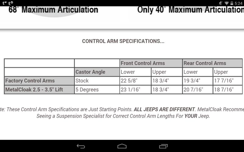

Originally Posted by jnabird333
This is from the MC site.... Upper is set 1" longer and lower is 1"ish to adjust for pinion angle
Attachment 540679
That must be old, that's not what it currently states on their site FYI. Or if it does it must be a page that wasn't updated because I clearly see 5/8.
Correct. Slightly less than 1" on lower and 1" on upper for a 4" lift. Upper length sets pinion for an aftermarket shaft. I cut about 3/4" off the upper as I have a stock rear shaft.

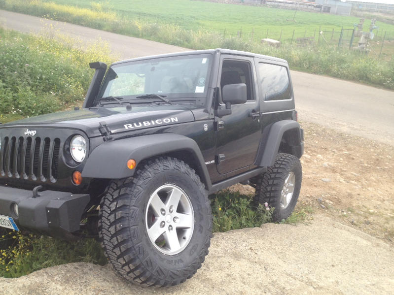

Finished MC 2.5" lift 35x12.50
I took that screenshot this morning off of the control arm page

Originally Posted by steel pirate
Making the all control arms an inch longer wouldn't move the axle back a whole inch because of angles and stuff.
You're right it moves it back six tenths of an and beyond the stock location. I understand how to do geometry and that's where I calculated the four tenths of an inch needed to put it back to the stock location.
