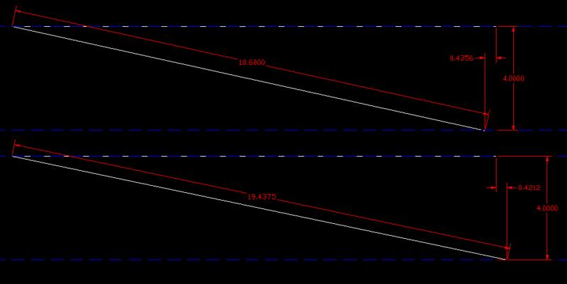

I see it I was looking at another illustration but I'm still not following your math. Plus it says in bold that this is a starting point only so even if they somehow blew the equation and were off by 2 inches on the length its still up to the end user to make the adjustment. If they were confident what they were providing was dead nuts for everybody they would be fixed length not adjustable. Of course they should be "close" though. I would be dissapointed if I got arms with the rod ends laying in a box and the instructions said "figure it out".
Maybe this will help. The white lines represent the arm lengths. My stock arms sat darn near level with the ground pre lift. The two blue dashed lines are 4" apart. I rotated one end until the opposite end was 4" lower. The upper diagram uses an 18.6" length because this is the difference between the stock arms. The lower uses 19.4375" because this is the difference between the MC arm suggested lengths. You will note that the lift causes the axle to move forward 0.4356" with the stock arms and pushes the axle BACK 0.4213" with the MC arms when referenced against the stock location.
Name:	Arm Length.jpg
Now, this is all theoretical. In reality I measured my axle to be roughly 5/8" (0.625") farther back post lift with the MC "starter" lengths. All this said, I absolutely agree with you that this is nothing more than a starting length and one should adjust as they see fit for their build from there. I am just sharing where my numbers came from
That is what is confusing me. I could swear on the MC site I read that it pushes the axle back 5/8 and you are saying that's what happened with yours. So I was trying to figure out how you both arrived at the same answer inputting different data. I could have just seen something wrong too who knows.
No matter as long as it all works out in the end!
Attachment 541025
That's what people need to understand "starting points"
Weight/actual height, pinion/caster angles, variances in the stock mounting positions, etc. No two jeeps will be the same. Start with the numbers provided and adjust from there.
The 1" stretch with some manufactures is to clear bigger tires. In some cases causes more issues then what it's worth IMO.
