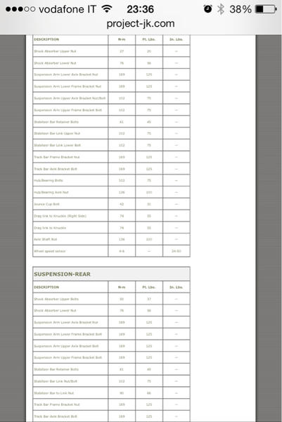

I ordered my 2.5 GC ARB yesterday. Now I am getting all my resources together. I thought I saw somewhere in this thread where someone posted all the torque values for the various bolts in the MC lift install. Has anyone else seen that? If not, does anyone know where I can look those values up?

thats not readable
Same values as stock. All control arms (except front uppers) are 125. Front uppers 75. Track bars 125. Lower shock bolts 56, rear upper 37. Front upper are impossible to get a torque on, but tight and start to squish the bushings.

Maybe this is clearer
