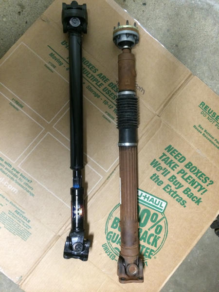

What isn't apparent to me is why a new drive shaft solves the problem ... Are they longer or different angle than stock?
Old May 9, 2014 | 03:16 AM
  #1178
Invest2m4's Avatar
Joined: Jun 2013
Posts: 3,697
From: Grosse Pointe, MI
The diameter is much smaller and therefore you can droop the front axle much further before contacting the exhaust crossover. Also, if you do contact, there is no rubber boot to tear and along grease.
Attachment 551577
thanks! very helpful picture. i guess new front driveshaft it is :(

From: calgary
And the skid hits exactly where that stupid boot is. Ask me how I know
