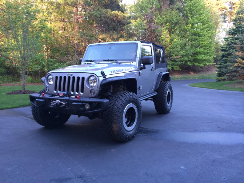

I do two arms at a time. Otherwise, it's a pain to bolt them up as one arm is longer. Put a GC ARB on my dad's jeep this weekend and had no issues. Track bars i do last and on flat ground.
Lift
That came out nice. Which fenders are those?
Yeah, the lift makes things a lot easier They are the Poison Spyder standard width. We put those on after the lift. Busy weekend: GC lift, PSC fenders, PSC diff covers, Adam's driveshaft, mounted and installed 5 Nitto's on 5 ATX Slabs. Also found time yesterday to put the extended brake lines on the rear (I don't use the front as it's not worth the spongy brake pedal risk and because the stock are plenty long).
