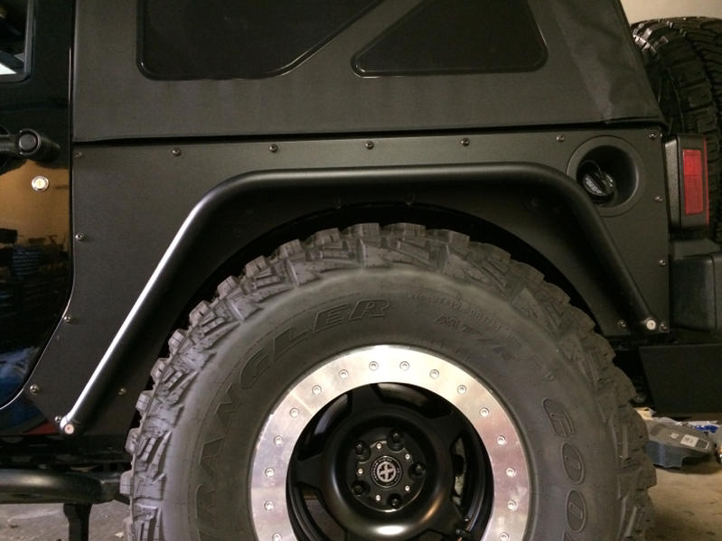

Ok, flex tested the rear. I have the 2.5" GC and have the new 2.5" TB bracket. No contact at full stuff. However, I'm running 37s and 2" of bump stop. I cut a lot of metal out of the wheels wells and with a bit of a trim on the front, I'll have no problem with 1" of bump in the rear. However, the 2.5" TB bracket will hit the crossmember. I'm going to notch it and weld in a gusset.
