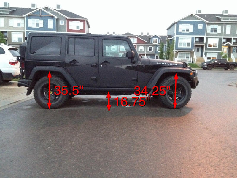

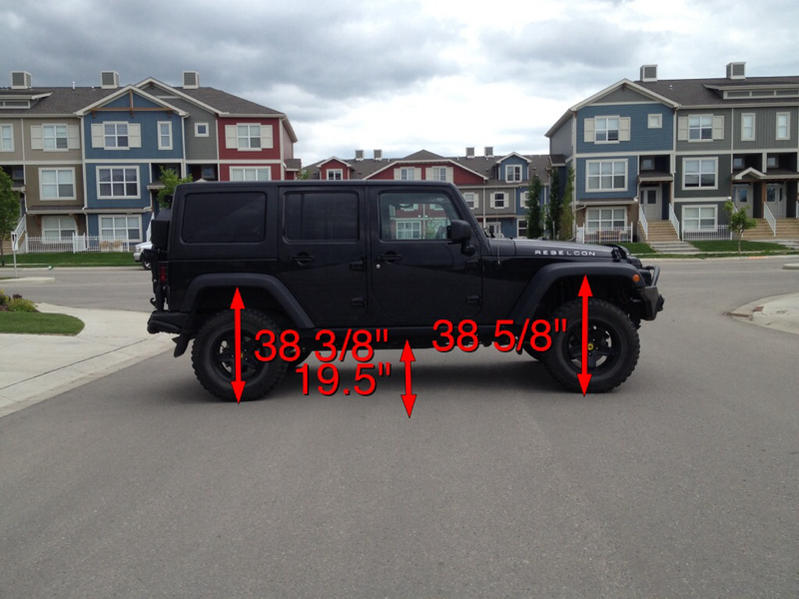

Finally got my lift installed.
Suppose to be 2.5 arb edition but it looks pretty high. Going to confirm they sent me the right lift kit. They already messed up with the brake line kit twice.
Here are the before and after. Stock rubicon tires
BEFORE:
AFTER:

Originally Posted by Monster696
Finally got my lift installed. Suppose to be 2.5 arb edition but it looks pretty high. Going to confirm they sent me the right lift kit. They already messed up with the brake line kit twice. Here are the before and after. Stock rubicon tires BEFORE: <img src="https://www.jk-forum.com/forums/attachment.php?attachmentid=559868"/> AFTER: <img src="https://www.jk-forum.com/forums/attachment.php?attachmentid=559869"/>
You look really low prior, so it's not a good comparison. Use the stock measurements to determine lift.
