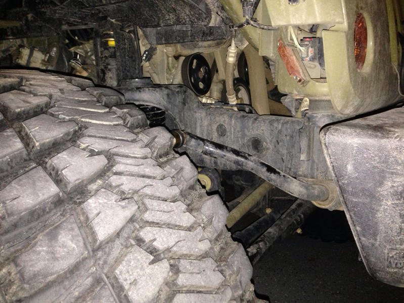

Well thank you! I also called MC about the front sway bar links being so long. Was told they are that way because of the amount of droop the suspension allows. The longer links keep the say bar from going inverted. Was assured that the longer link causing the sway bar to be at such a drastic looking angle would be perfectly fine. Looks like I'll be swapping the rears off the front and put the correct ones on later today Sent from my iPhone using JK-Forum
Pics after install would be appreciated.

Swaybar links installed...

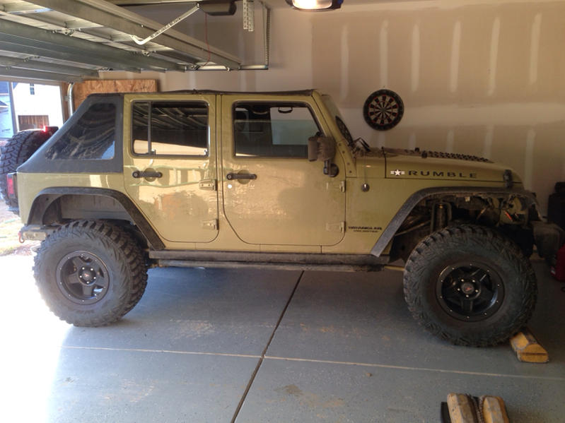

Final stance with level 8 ZX rick rings installed

I hate to say it Shane but your tires are too small now! Time for 37"!!
